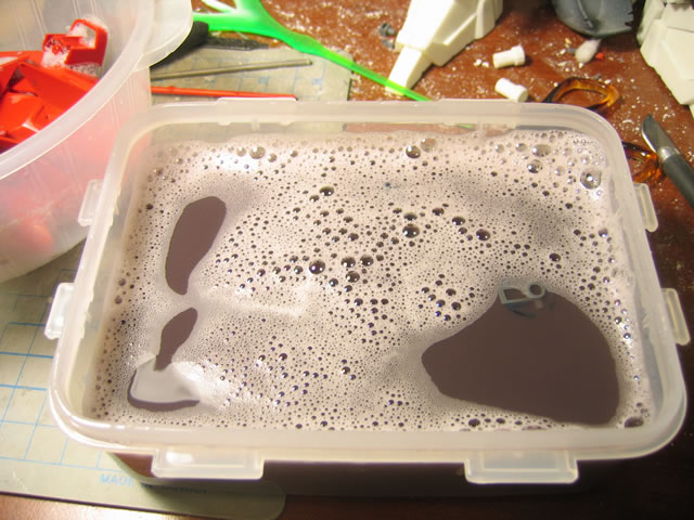

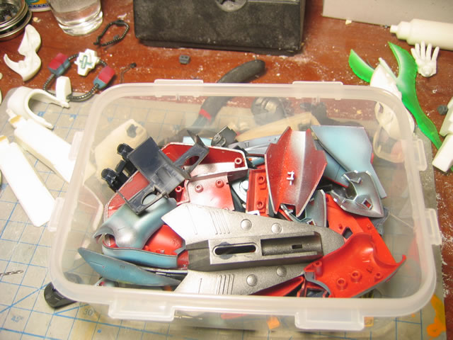

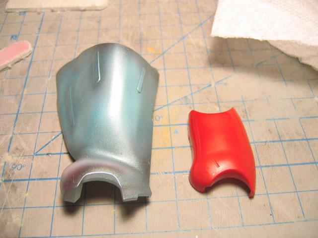

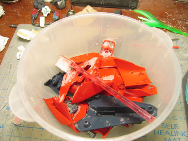

Okay... I retested it on another model that I've been having problems with the paint job. It appears to be safe on enamel (might not be if soak overnight). I have been working on a Sayla Mass model and I had repeated problems with the paint job. I had use a enamel grey primer, Tamiya paint, Future Floor Wax and Delta Ceramcoat Exterior Clear Coat. This took only 3 minutes to strip. If you look at the photos below you can see the results. Tamiya paint, Future Floor Wax and Delta Ceramcoat Exterior Clear Coat (All 3 are Acrylic paints) normaly require alcohol and/or lacquer thinner to strip which gets messy, toxic, and always some left over glop that sticks around. Look how fast Oxi Clean strip the paints that had been on the model for 6 months. I didn't have to use a glove to do this. All the paint started to dissolves on the first minute... and I gave it a really thick paint job. The enamel primer underneath was not affected by the Oxi Clean. With a tooth brush and a minor gentle scrubbing of the parts in the container bath, I have remove all the Acrylic paint from the kit without damaging the enamel coating or resin. The only thing left is pour out the stuff and rinse everything with water. Not a drop of sticky paint left... not even on my hands!
